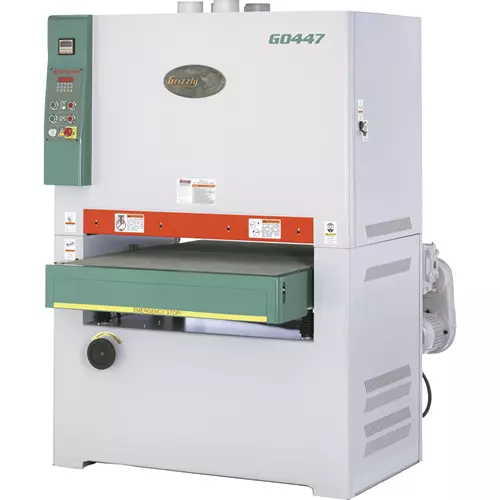

Rarely can a machine claim to cut your sanding time in half.
The G0447 37" 20 HP 3-Phase Double Head Wide-Belt Sander features dual heads enabling them to sand to finer grits in a single pass!
The first belt runs on a single drum and the rear belt runs on a platen system which allows you to adjust the sanding depth.
The sandpaper length needed is 37" wide by 75" long. A full range of replacement belts are available.
If you are still sanding through two different grit levels using a single head wide-belt sander you are not being the most efficient.
The G0447 manual was written by our U.S.-based Technical Documentation Department and is packed with useful information. The complete and easy-to-read manual makes it easier to assemble and maintain your sander.
CSA certified
*This machine is prewired for 220V. We can rewire to 440V in a few days’ time for a fee. Please contact Grizzly Technical Support at (570) 546-9663 before placing your order.
  • Sanding motor HP: 20 HP, 220V/440V* (prewired 220V), 3-phase, 50.3A/25.1A
  • Conveyor motor HP: 1 HP, 3.4A/1.7A
  • Table lift motor HP: 1/4 HP, 1.2A/0.6A
  • Minimum circuit size: 70A @ 220V, 40A @ 440V
  • Maximum board width: 36-1/2"
  • Maximum board thickness: 6"
  • Minimum board length: 11"
  • Minimum board thickness: 3/16"
  • Front drum surface speed: 3500 FPM
  • Rear drum surface speed: 2600 FPM
  • Conveyor speed: 14–60 FPM
  • Sanding belt size: 37" x 75"
  • Air requirement: 57–75 PSI, 12.3 CFM
  • Dust ports: 6 x 4"
  • Footprint: 52" x 31"
  • Overall dimensions: 53-1/2" W x 59-1/2" D x 79" H
  • Approximate shipping weight: 2920 lbs.
  • Rubber pressure rollers
  • Hard rubber infeed drum
  • Adjustable graphite platen
  • Digital encoder depth control
  • Amp/load meter
  • Disc brake for emergency stop
  • Variable feed speed
  • 1-year limited warranty
