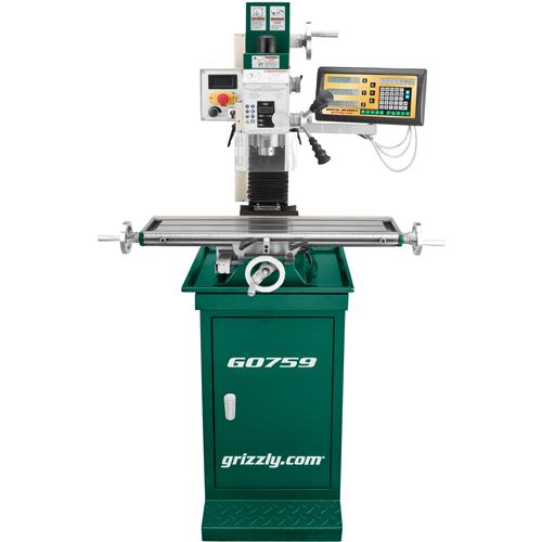

G0759 7" x 27" 1 HP Mill Drill w/ Stand & DRO
Upgrading America's most popular mill drill.
The G0759 7" x 27" 1 HP Mill Drill upgrades America's most popular mill drill with the addition of the 3-Axis DRO.
It is an affordable alternative to larger mill drills that offer similar features. It functions great as a dedicated single-purpose milling machine in a professional shop or as a starting point for those just expanding into milling operations.
With this machine you'll get all the benefits of the G0704 plus exact tool and table positioning with the 3-axis DRO.
The variable-speed 1 HP motor powers the R-8 spindle from 50-1125 RPM in low and 100-2250 RPM in high. Spindle RPM can be monitored on the convenient digital readout. A clear chip guard on the spindle keeps debris from flying at the operator.
The G0759 has a large 7-1/16" x 26-5/8" table that can be moved by handwheels in both the longitudinal and cross directions. Both feed directions can be locked by table lock levers.
The G0759 also features tapered gibs with double locks which adds accuracy and rigidity, a dovetail column; and it comes with its own stand.
