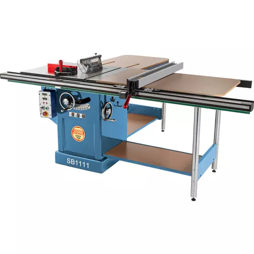

SB1111 10" 3 HP 220V Table Saw with Extension Rails
A high-quality table saw is the most important investment you'll make as a woodworker.
The high-precision South Bend SB1111 10" 3 HP Table Saw with Extension Rails is solidly built with a higher degree of accuracy, high-end components, and longer-lasting reliability than any other table saw on the market.
The rip capacity of the SB1111 with the extension rails is 52" to the right and 18" left of the blade.
A digital readout on the fence for width of cut, and two digital readouts on the control panel for blade height and tilt allow you to set up your cuts with absolute precision every time.
The 1-1/2" thick, precision-ground cast-iron table mounted on the heavy-duty, one-piece steel cabinet to minimize vibration during operation.
Additional features, such as a locking ON/OFF switch for safety, large cast-iron handwheels for easy adjustments, and large anodized handles on the miter gauge and rip fence add a professional touch.
Achieve professional results with this superb South Bend table saw.

  • Motor: 3 HP, 220V, single-phase, 13A
  • Rip capacity: 52" right, 18" left of blade
  • Maximum depth of cut @ 90°: 3-1/8"
  • Maximum depth of cut @ 45°: 2-1/8"
  • Overall table dimensions: 76" W x 65-5/8" D
  • Distance from front of table to center of blade: 14-7/8"
  • Floor-to-table height: 35-3/4"
  • Arbor diameter: 5/8"
  • Arbor speed: 4000 RPM
  • Maximum width of dado: 3/4"
  • Dust port size: 4"
  • Cabinet footprint: 22" x 24"
  • Overall dimensions: 91-1/2" W x 73" D x 43-1/2" H
  • Approximate shipping weight: 792 lbs.
  • Digital readouts for:
    • Blade height
    • Blade angle
    • Fence to blade
  • Precision-ground cast-iron table with beveled edge
  • Locking power ON/OFF switch with key
  • One-piece steel cabinet
  • Angled dust chute
  • Large cast-iron handwheels
  • Anodized handles on miter gauge and rip fence
  • Two 3/4" miter slots in table
