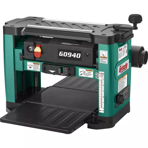

G0940 13" 2 HP Benchtop Helical Planer with Granite Table
An amazing planer with unique granite table.
Benchtop planers are straightforward to use to surface rough lumber, create uniform thickness in boards, and make precise cuts.
This top-of-the-line 13" 2 HP Benchtop Planer with Helical Cutterhead comes with features you would expect from only the best.
The G0940 takes those features one step further with a super flat granite main table.
The granite table base provides exceptional stability, never rusts, and stays smooth and even for the life of the planer compared to steel bases that may deflect or sag in the planing process.
The helical cutterhead has 30 inserts arranged in two rows for smooth shearing cuts, minimized tearout, a smoother finish, and operating at lower noise levels.
Featuring a fixed-height table design, the cutterhead raises and lowers for thickness adjustments, as opposed to the table. This allows for permanent infeed and outfeed table setups.
A depth-of-cut indicator that reads up to 1/8" helps you track planing depth.
An adjustable cutterhead depth stop allows for repeatable planing operations to speed up production, reduce downtime, and improve efficiency.
Keep your workspace clean with the easily adjustable dust chute. Simply loosen two screws, rotate the chute to your preferred left or right position, and tighten the screws.
The easy carry handles make this planer great for the job site and can be easily stowed-away after use in any home shop.
You just can’t beat the value and performance of one of the best benchtop planers.
The H9893 replacement inserts are available when the stock inserts get dull.
