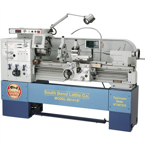

SB1013F 14" x 40" EVS 440V Toolroom Lathe with Fagor DRO
For when EVS is the minimum you require on a 440V lathe.
The electronic variable-speed (EVS) spindle control of the SB1013F allows the operator to quickly set the exact spindle speed within the available range of 20–2500 RPM. Spindle speed is displayed on the digital readout.
The beds are constructed with Meehanite® castings that have been precision-ground and hardened in the traditional three-V prismatic design.
The feed rod includes a slip clutch that disables automatic carriage feed in the event of a crash or when it contacts the feed stop.
The spindles are the D1-6 camlock type with an MT#6 taper and 2.0625" bore. The tailstock quills offer 6" of travel and have a MT#4 taper.
The SB1013F manual was written by our U.S.-based Technical Documentation Department. The complete and easy-to-read manual provides full instructions on how to assemble and maintain your lathe.
The South Bend Technical Support team is U.S.-based. Parts for the lathe may be available online and shipped from the parts warehouse in Springfield, MO.
