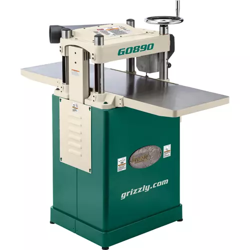

G0890 15" 3 HP Fixed-Table Planer
Boost efficiency with the fixed table height design.
The G0890 15" Fixed-Table Planer with a 3-knife cutterhead features a unique fixed table height design which allows for a permanent infeed/outfeed roller table setup. This can significantly boost efficiency in production settings.
Gas struts allow you to easily lift the headstock to accommodate board thickness changes while keeping your infeed and outfeed tables in place.
A 230-volt, 3 horsepower motor powers through cuts up to 1/8" deep at full width or 3/16" deep on material up to 6" wide.
The 2-speed gearbox allows you to choose between 16 and 28 FPM for a smooth finish or high-production feed rate.
The 2-5/8" diameter, 3-knife cutterhead has HSS blades. HSS (high-speed steel) has been heat treated for hardness and wear resistance, which keeps a sharp edge longer than other carbon steels.
The G0890 offers additional features such as a thickness scale, a large top-mounted handwheel, cabinet-style stand, cast-iron extension tables, angled dust port, and magnetic switch with thermal overload protection.
Ready to be your workhorse for the next decade-plus!

- Motor: 3 HP, 230V, single-phase, 12A
- Minimum circuit size: 20A
- Maximum stock width: 15"
- Maximum stock thickness: 6"
- Minimum stock thickness: 3/16"
- Minimum stock length: 6"
- Maximum cut depth full width: 1/8"
- Maximum cut depth 6" wide: 3/16"
- Cutterhead diameter: 2-5/8"
- Cutterhead type: 3-Knife
- Knife size/type: 15" x 1" x 1/8", HSS
- Cutterhead speed: 5200 RPM
- Feed rates: 16 FPM, 28 FPM
- Table dimensions: 57" L x 25" W
- Dust port size: 4"
- Footprint: 21" x 18-1/2"
- Overall dimensions: 25" W x 49" L x 47-1/2" H
- Approximate shipping weight: 374 lbs.
- Fixed-height table design allows for permanent infeed/outfeed roller table setup
- Twin gas struts for headstock lifting assist
- Twin feed-rate for rough and finish planing
- Cast-iron table with extension wings
- Magnetic switch with thermal overload protection
