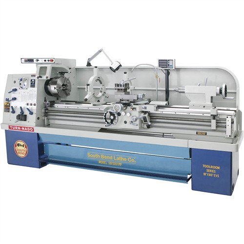

SB1061PF 18" x 80" EVS Lathe with Fagor DRO
South Bend quality is built into every one of these fantastic gearhead lathes!
Features of the SB1061PF 18" x 80" Lathe include an extra-long saddle for stability, pull out chip pan, and of course, a full complement of standard equipment.
The dial-controlled, electronically variable spindle speed between 18–1800 RPM is displayed on a 2-axis Fagor digital readout.
This EVS lathe is supplied with an adjustable feed rod clutch and stop collar on the feed rod.
The bed of the lathe is constructed with Meehanite® castings that are hardened and precision-ground in the traditional three V-way prismatic design.
Quality Allen-Bradley® electrical components and attention to detail provide dependable electrical control of the powered movements.
And finally, this lathe comes with a circulating coolant system.
