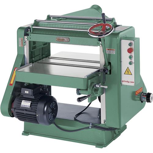

G5851Z 24" 5 HP Planer
Durability, dependability, and capacity are the hallmarks of this massive planer.
Are you needing to plane wide, solid wood panels? No problem! The 5 HP, single-phase motor of the G5851Z 24" Planer powers through the toughest hardwoods with ease.
The G5851Z features a 24” planing capacity and four high-speed steel knives (HSS) on the 3-1/8” cutterhead.
The HSS knives have been heat treated for hardness and wear resistance, which keeps a sharp edge longer than other carbon steels.
The built-in chip deflector leads directly into the dust hood with a 5” dust port to help ensure the work area stays as clear as possible.
The large, conveniently located handwheel facilitates bed adjustment.
The G5851Z manual was written by our U.S.-based Technical Documentation Department and is packed with useful information.
Parts for the planer may be available online and shipped from the Grizzly parts warehouse in Springfield, MO.
  • Main motor: 5 HP, 220V, single-phase, 25A
  • Feed motor: 2 HP, 14A
  • Maximum stock width: 24"
  • Maximum stock thickness: 7"
  • Minimum stock thickness: 1/4"
  • Minimum stock length: 8"
  • Maximum cutting depth planing full width: 1/16"
  • Maximum cutting depth planing 6" wide board: 1/8"
  • Cutterhead diameter: 3-1/8"
  • Cutterhead type: 4-knife
  • Knife size and type: 24" x 1" x 1/8", HSS, single-sided
  • Cutterhead speed: 5200 RPM
  • Feed rate: Variable, 17–26 FPM
  • Table size with extensions: 24-1/8" x 31-1/8"
  • Dust port size: 5"
  • Footprint: 20-1/2" x 24-1/2"
  • Overall dimensions: 42" W x 40-1/2" D x 37" H
  • Approximate shipping weight: 1126 lbs.
  • Board return rollers
  • Grease fittings for cutterhead ball bearings
  • Heavy-duty cast-iron construction throughout
  • Lever-adjustable bed rollers
  • Handwheel table height adjustment
  • Segmented chip breaker and infeed roller
  • Finely finished steel outfeed roller
  • Inch and metric scale increments
  • Dust covers protect vertical support columns and leadscrews
