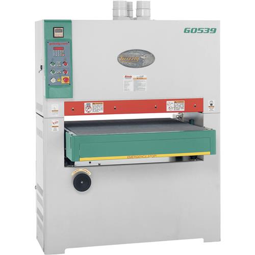

G0539 37" 15 HP 3-Phase Wide-Belt Sander
Filling in the gap between the popular 25" and 43" wide-belt sanders.
The G0539 37" 15 HP 3-Phase Wide-Belt Sander offers professional sanding results, unmatched accuracy, and unbeatable value.
The table height can be adjusted manually or with the state-of-the-art digital controls.
The amperage draw meter is located directly above the control panel.
The G0539 is equipped with a micro-adjustable graphite/felt platen for those extra sensitive sanding operations.
The 37" x 60" sanding belt oscillation is adjustable between 5/8" and 3/4" to yield different sanding results.
A full range of replacement belts are available.
- Sanding motor HP: 15 HP, 220V/440V* (prewired 220V), 3-phase, 36.7A/18.4A
- Conveyor motor HP: 1 HP, 3.4A
- Table lift motor HP: 1/4 HP, 1.2A
- Minimum circuit size: 50A @ 220V, 30A @ 440V
- Maximum board width: 36-1/2"
- Maximum board thickness: 6"
- Minimum board length: 14"
- Minimum board thickness: 1/8"
- Front drum surface speed: 2600 FPM
- Conveyor speed: 15–49 FPM
- Sanding belt size: 37" x 60"
- Oscillations: 5/8"–3/4"
- Air requirement: 57–70 PSI, 7 CFM
- Footprint: 51-1/2" x 19"
- Overall dimensions: 53" W x 69-1/2"x 69-1/2" H
- Approximate shipping weight: 1781 lbs.
- Built in air filter/lubricator
- Independent motor control
- Pneumatic belt tracking and tensioning
- Amp meter for load measurement
- Safety shut-off bar
- Digital readout and control panel
- (3) 5" dust ports
- Steel cabinet
- Rubber infeed drum
- Steel outfeed drum
- Rubber pressure drums
- Micro-adjustable graphite/felt platen
*This machine is prewired for 220V. We can rewire to 440V in a few days’ time for a fee. Please contact Grizzly Technical Support at (570) 546-9663 before placing your order.
We offer U.S.-based customer service and technical support to get your questions answered and help keep your equipment running in top condition. And to ensure your satisfaction, the G0539 comes with a 1-year warranty.
