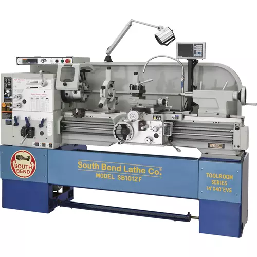

SB1012F 14" x 40" EVS Toolroom Lathe
For when Electronic Variable-Speed (EVS) is the minimum requirement of your toolroom.
Loaded with all the essential features and high-precision parts, the SB1012F 14" x 40" EVS Toolroom Lathe excels at making dies, fine tools, jigs and fixtures.
Featuring EVS (Electronic Variable-Speed) spindle control, which allows the operator to quickly set the exact spindle speed within the available range of 20–2500 RPM.
A Fagor DRO conveniently reads the position of the apron or cross slide movement.
The bed of the SB1012F is constructed with Meehanite® castings that have been induction-hardened and ground in the traditional 3-V prismatic design.
The SB1012F manual was written by our U.S.-based Documentation Department and is packed with useful information. The complete and easy-to-read manual makes it easier to assemble and maintain your lathe.
The South Bend Technical Support team is U.S.-based.
