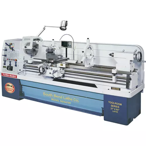

SB1047PF 21" x 80" Turn-Nado Gearhead Lathe with DRO
A gearhead lathe built for daily use in a busy industrial setting.
The SB1047PF 21" x 80" Turn-Nado Gearhead Lathe is driven by a fixed speed 15 HP motor with quick-change gear levers to control the 16 spindle speeds between 20–1600 RPM.
It features a spindle clutch that allows the operator to switch between forward and reverse without shutting down the motor—a great time saver.
To further ensure a high degree of accuracy, this lathe is equipped with high-quality spindle bearings. The spindles are D1-8 camlock with an MT#7 taper and 3.15" bore. The tailstocks have an MT#5 taper and 6-1/2" of quill travel.
A factory-installed Fagor digital readout displays the positioning of the carriage and cross slide.
The headstock is equipped with a pressurized oiling system that pre-lubricates the bearings and gears before the spindle starts.
The bed of the lathe is constructed with Meehanite® castings that are hardened and precision-ground in the traditional three V-way prismatic design.
Quality Allen-Bradley® electrical components and attention to detail provide dependable electrical control of the powered movements.

  • Spindle motor: 15 HP, 440V, 3-phase, 19A
  • Coolant pump motor: 1/8 HP, 0.23A
  • Swing over bed: 21"
  • Distance between centers: 80"
  • Swing over cross slide: 14"
  • Swing over saddle: 21"
  • Swing over gap: 31"
  • Maximum tool bit size: 1"
  • Carriage travel: 79"
  • Compound travel: 5.39"
  • Cross slide travel: 11"
  • Spindle speeds: Variable, 20–1600 RPM
  • Longitudinal feeds: 0.0015 to 0.0400 IPR (15)
  • Cross feeds: 0.00075 to 0.020 IPR (15)
  • Inch thread range: 2 to 72 TPI (38 pitches)
  • Metric thread range: 0.4 to 14 mm (40 pitches)
  • Modular threads: 0.3 to 3.5 (18 pitches)
  • Diametral threads: 8 to 44 (21 pitches)
  • Overall dimensions: 130-1/4" W x 27" D x 54-3/4" H
  • Approximate shipping weight: 6020 lbs.
  • Fagor 2-axis DRO
  • Meehanite® castings
  • Allen-Bradley® controls
  • SKF spindle bearings
  • 14" 4-jaw independent chuck D1-8
  • 12" 3-jaw scroll chuck mounted to D1-8 plate
