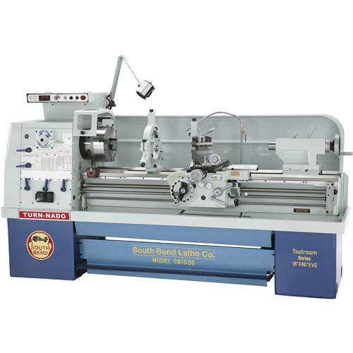

SB1036 18" x 60" Lathe 440V
This lathe is truly designed to get the job done efficiently and to spec every time.
Quality and precision have been the hallmark in the production of the SB1036 18" x 60" Lathe 440V and it shows in every detail—from its surface finishes to its mass and power.
Strict adherence to details like hardened and ground ways, extra-long saddle, 6.5" of stroke in the tailstock, pressurized spindle lube, extra wide gears in the headstock and of course, electronic variable-speed make this machine a pleasure to use and ensures long term durability.
The SB1036 comes with a full package of accessories: 3-jaw and 4-jaw chucks, faceplate, follow and steady rests, and flood coolant just to name a few.
Like all South Bend lathes, the SB1036 comes with a 2-year warranty covering parts and assuring the unit is free from factory defects. (Consumables are not covered by the warranty.)
The SB1036 manual was written by our U.S. based Documentation Department and is packed with useful information. The complete and easy-to-read manual makes it easier to assemble and maintain your lathe.
The South Bend Technical Support team is U.S. based. Parts and accessories for the lathe may be available online and shipped from the parts warehouse in Springfield, MO.
