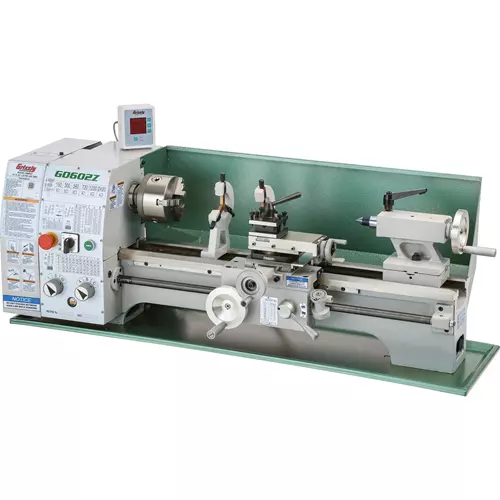

G0602Z 10" x 22" Benchtop Metal Lathe with DRO
Master small-scale metalworking.
The G0602Z Benchtop Metal Lathe combines space-saving design with exceptional precision and versatility. Hardened and ground V-ways ensure smooth operation, while the X/Z-axis DRO with 0.001-inch resolution eliminates guesswork for accurate cuts on every project.
This versatile lathe tackles intricate model parts, powerful engines, and everyday repairs with ease, making it a favorite for workshops, garages, and hobbyists of all skill levels.
If you are thinking of making parts for models or engines, or even repairs around the home or shop, this is the lathe for you! The thread dial simplifies threading projects, while the spindle reversing switch and inch/metric dials offer convenient control.
For added safety, the lathe features an emergency stop button and a chip tray to keep your workspace clean. The enclosed oil-bath gearbox provides quiet operation and efficient lubrication, extending the life of your lathe.
The G0602Z manual was written by our U.S.-based Technical Documentation Department and is packed with useful information.
  • Motor: 1 HP, 110V, single-phase 13.6A
  • Swing over bed: 9-1/2""
  • Swing over cross slide: 6-1/8"
  • Swing over saddle: 6-1/8"
  • Distance between centers: 22"
  • Bed width: 6-1/8"
  • Spindle speeds: (6) 150–2400 RPM
  • Spindle bore: 25mm
  • Spindle type: Threaded, 1-3/4" x 8 TPI
  • Spindle taper: MT#4
  • Tailstock taper: MT#3
  • Tailstock quill travel: 2-1/2"
  • Cross slide travel: 6-1/2"
  • Compound travel: 3-1/2"
  • Maximum tool bit size: 1/2"
  • Leadscrew: 3/4" x 12 TPI
  • Longitudinal feeds: (9) 0.0025, 0.0140 in./rev.
  • Inch thread range: (31) 8–72 TPI
  • Metric thread range: (26) 0.25–3.50mm
  • Overall dimensions: 46" W x 22" D x 21" H
  • Approximate shipping weight: 432 lbs.
  • Magnetically mounted X/Z-Axis DRO with resolution of 0.001"
  • Hardened and ground V-ways
  • Thread dial
  • Spindle reversing switch
  • Inch/metric dials
  • Emergency stop button
  • Quick-locking tailstock
  • Enclosed oil-bath gearbox
  • Chip tray and backsplash guard
