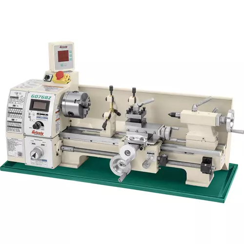

G0768Z 8" x 16" Variable-Speed Lathe with X/Z-Axis DRO
A versatile and precise lathe for making parts.
The Grizzly G0768Z features an electronic variable-speed spindle control that ensures cutting precision on every project.
Take advantage of the high/low speed ranges and digital RPM readout to increase your efficiency.
And, with a X/Z-Axis DRO, you can closely monitor cross slide and carriage travel for the accuracy needed for each step.
This specialized lathe is also equipped with a quick-lock tailstock for smooth and easy adjustments; keep your productivity up while on the job site or in your home workshop!
The G0768Z works perfectly on sturdy workbench or as a stand-alone unit when mounted on the T26599 Optional Stand.
Additionally this lathe has a convenient quick-lock tailstock, reverse feed for cutting left-hand threads, and a great selection of included standard equipment.
The G0768Z manual was written by our U.S.-based Documentation Department is packed with useful information.
Parts for the lathe may be available online and shipped from the Grizzly parts warehouse in Springfield, MO.
  • Motor: 3/4 HP, 110V, single-phase, 10A
  • Swing over bed: 8-1/4"
  • Swing over cross slide: 4-5/8"
  • Swing over saddle: 6-7/8"
  • Distance between centers: 15-3/4"
  • Bed width: 4"
  • Spindle bore: 0.787" (20mm)
  • Spindle taper: MT#3
  • Tailstock taper: MT#2
  • Tailstock quill travel: 2"
  • Cross slide travel: 3"
  • Compound travel: 2-1/8"
  • Spindle speed: Variable, 50–2000 RPM
  • Longitudinal feeds: (2) 0.0037, 0.0068 in./rev.
  • Inch thread range: (15) 9–44 TPI
  • Metric thread range: (12) 0.4–3.0mm
  • Footprint: 10-1/2" x 31-1/2"
  • Overall dimensions: 36" W x 16" D x 18" H
  • Approximate shipping weight: 166 lbs.
  • Magnetically mounted X/Z-Axis DRO
  • Electronic variable-speed spindle control with digital readout
  • High and low variable spindle speed ranges
  • Chip tray and backsplash guard
  • Thread dial indicator
  • Emergency stop button
  • Quick-locking tailstock
  • 1-year limited warranty
INCLUDES:
  • 4" Three-jaw scroll chuck with two sets of jaws
  • 4" Four-jaw independent chuck with reversible jaws
  • 6-3/4" Faceplate
  • 4-Way turret tool post
  • Follow rest
  • Steady rest
  • Tool box with service tools
  • Bottle for oil
  • Replacement fuse
  • MT#2 and MT#3 dead centers
