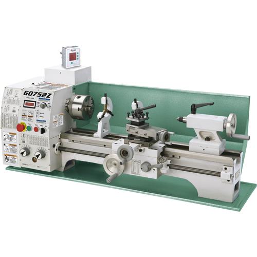

G0752Z 10" x 22" Variable-Speed Benchtop Lathe with 2-Axis DRO
Upgrading the 10" x 22" lathe to the max!
The Grizzly G0752Z is the variable-speed version of our G0602Z 10" x 22" Bench Lathe. With features such as a 25mm spindle bore, an MT#3 tailstock and 3/4"–12 TPI leadscrew, you'll be able to turn some surprisingly burly projects!
G0752Z comes with electronic variable-speed spindle control, which allows you to change spindle speeds at the turn of a dial while the lathe is still running. This feature eliminates the additional time it takes to stop the motor and then change gears or move levers around when changing spindle speeds.
The fine degree of control of the digital RPM display on the headstock allows you to set the optimum spindle speed for your feed speed and workpiece material, so that you can get the best finishes possible.
