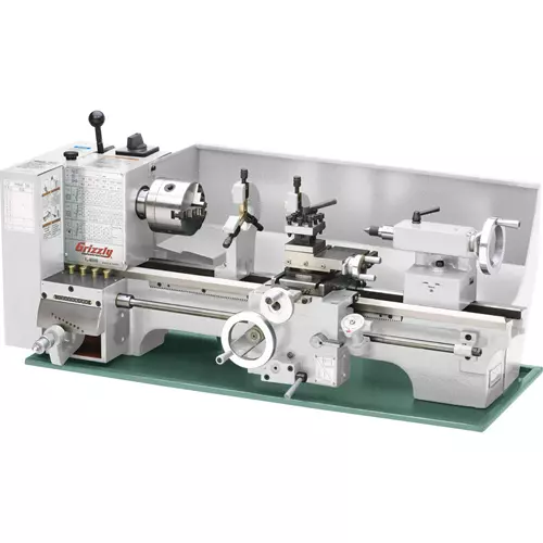

Grizzly G4000 9" x 19" Bench Metal Lathe
The perfect combination of price and performance.
The Grizzly G4000 9" x 19" Bench Lathe is a great lathe for those getting started in metalworking.
It has a number of features and capabilities typically only found on higher-end lathes and it's jam-packed with standard accessories.
The compact size allows this lathe to be mounted to an existing workbench or on the optional G4001 stand.
You won't find a better combination of price and performance on a full-featured 9" x 19" lathe anywhere!

  • Motor: 3/4 HP, 110V, single-phase 9A
  • Swing over bed: 8-3/4"
  • Swing over cross slide: 5"
  • Distance between centers: 19"
  • Bed width: 4-1/2"
  • Spindle speeds: 6, 130–2000 RPM
  • Spindle bore: 0.78" (20mm)
  • Spindle type: Threaded, M39-4.0
  • Spindle taper: MT#3
  • Tailstock taper: MT#2
  • Tailstock quill travel: 1-9/16"
  • Cross slide travel: 4-1/4"
  • Compound travel: 1-7/8"
  • Maximum tool bit size: 3/8"
  • Leadscrew: 9/16" x 16 TPI
  • Longitudinal feeds: (4) 0.0047–0.0120 in./rev.
  • Inch thread range: (27) 8–56 TPI
  • Metric thread range: (11) 0.5–3.0mm
  • Footprint: 16" x 37"
  • Overall dimensions: 37" W x 20" D x 15" H
  • Approximate shipping weight: 294 lbs.
INCLUDES:
  • 4" Three-jaw chuck with two sets of jaws
  • 7-1/4" Four-jaw chuck with reversible jaws
  • Steady rest
  • Follow rest
  • MT#2 dead center
  • MT#3 dead center
  • MT#2 live center
  • 4-Way tool post
  • Chip tray and splash guard
  • Threading dial
  • Faceplate
  • Extra C-type tool post
  • Tool box & tool kit
