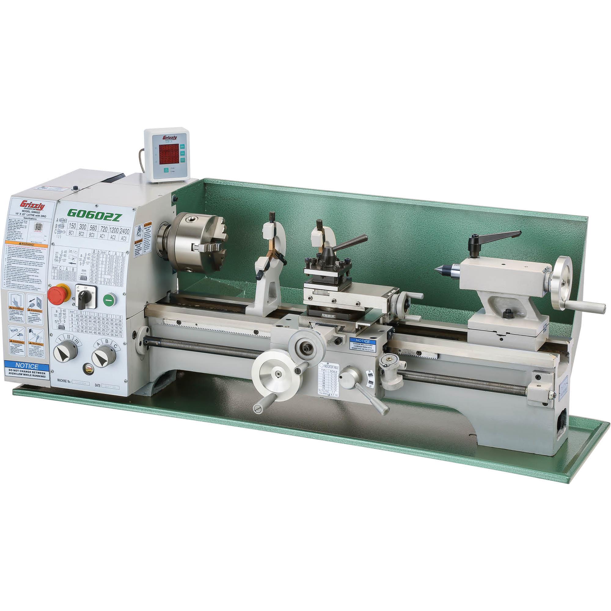

G0602Z 10" x 22" Benchtop Metal Lathe with DRO
Master small-scale metalworking.
The G0602Z Benchtop Metal Lathe combines space-saving design with exceptional precision and versatility. Hardened and ground V-ways ensure smooth operation, while the X/Z-axis DRO with 0.001-inch resolution eliminates guesswork for accurate cuts on every project.
This versatile lathe tackles intricate model parts, powerful engines, and everyday repairs with ease, making it a favorite for workshops, garages, and hobbyists of all skill levels.
If you are thinking of making parts for models or engines, or even repairs around the home or shop, this is the lathe for you! The thread dial simplifies threading projects, while the spindle reversing switch and inch/metric dials offer convenient control.
For added safety, the lathe features an emergency stop button and a chip tray to keep your workspace clean. The enclosed oil-bath gearbox provides quiet operation and efficient lubrication, extending the life of your lathe.
