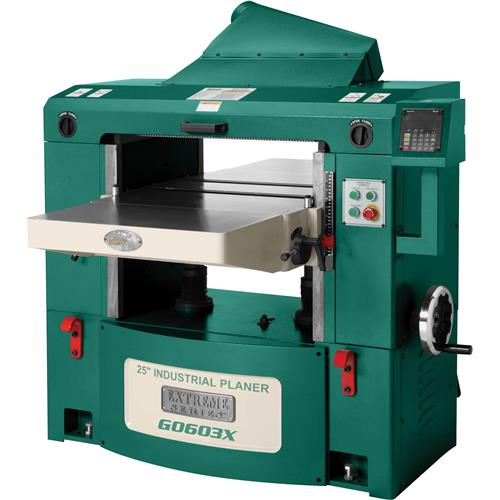

G0603X 25" 15 HP 3-Phase Extreme Duty Planer with Helical Cutterhead
Smooth and flatten rough, uneven lumber with ease.
The G0603X 25" 3-Phase Extreme Duty Planer has an incredible 15 HP motor to make quick work of those big planing jobs.
The G0603X features a helical cutterhead with 174 inserts rotated at 15° for smooth shearing cuts, minimized tearout, a smoother finish, and operating at lower noise levels.
The motorized table is great for making large thickness changes. Simply push the up or down control for fast elevation changes.
The highly programmable digital control has a convenient readout so you always know what thickness the planer is set on.
Simply enter a desired thickness on the easy-to-use keypad and the planer adjusts the table to your entry. Automatic adjustments only go down to 5/16". Dimensions less than 5/16" must be adjusted by hand.
The segmented chip breaker leads directly into the dust hood with a 5" dust port to help ensure the work area stays as clear as possible.
No more thickness gauges or guesswork. This planer delivers accurate cuts.
The H9893 replacement inserts are available when the stock inserts get dull.
The G0603X manual was written by our U.S.-based Technical Documentation Department and is packed with useful information.
*This machine is prewired for 220V. We can rewire to 440V in a few days’ time for a fee. Please contact Grizzly Technical Support at (570) 546-9663 before placing your order.
  • Main motor: 15 HP, 220V/440V* (prewired for 220V), 3-phase, 37A/18.5A
  • Table elevation motor: 1/2 HP, 3-phase, 2A/1A
  • Minimum circuit size: 50A @ 220V, 30A @ 440V
  • Maximum stock width: 25"
  • Maximum stock thickness: 9"
  • Minimum stock thickness: 1/4"
  • Minimum stock length: 10"
  • Maximum cutting depth: 1/8"
  • Cutterhead diameter: 3-1/2"
  • Cutterhead type: 6-Row helical with 174 inserts
  • Insert size and type: 15 x 15 x 2.5mm, Indexable carbide
  • Feed rate: 20, 25, 30 FPM
  • Table size with extensions: 25-1/8" W x 69-5/8" L
  • Table movement: 9"
  • Footprint: 47-1/4" x 22"
  • Overall dimensions: 54-1/2" W x 57" D x 54-1/2" H
  • Approximate shipping weight: 2054 lbs.
  • Digitally controlled table elevation
  • Segmented chip breaker
  • 5" dust port
  • Micro-adjustable table height
  • Serrated steel infeed roller
  • Finished steel outfeed roller
  • Adjustable bed rollers
  • Easy-access cutterhead
  • 3-Speed (20, 25, 30) feed rate
  • Inch/metric readout
  • Emergency stop button
