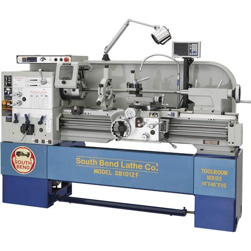

SB1012F 14" x 40" EVS Toolroom Lathe
For when Electronic Variable-Speed (EVS) is the minimum requirement of your toolroom.
Loaded with all the essential features and high-precision parts, the SB1012F 14" x 40" EVS Toolroom Lathe excels at making dies, fine tools, jigs and fixtures.
Featuring EVS (Electronic Variable-Speed) spindle control, which allows the operator to quickly set the exact spindle speed within the available range of 20–2500 RPM.
A Fagor DRO conveniently reads the position of the apron or cross slide movement.
The bed of the SB1012F is constructed with Meehanite® castings that have been induction-hardened and ground in the traditional 3-V prismatic design.

SPECIFICATIONS
  • Required power source: 220V, 3-phase, min. 20A circuit
  • Spindle motor: 5 HP, 220V
  • Oil pump motor: 1/4 HP
  • Coolant Pump Motor: 1/8 HP
  • Swing over bed: 14.17"
  • Swing over gap: 20.98"
  • Swing over cross slide: 8.38"
  • Cross slide travel: 9.25"
  • Compound travel 5.10"
  • Distance between centers: 40.00"
  • Spindle bore: 2.0625"
  • Spindle speeds: Variable, 20–2500 RPM
  • Spindle taper: MT#6
  • Tailstock taper: MT#4
  • Tailstock quill travel: 6.00"
  • Inch threads: (45) 2 to 72 TPI
  • Metric threads: (39) 0.20 to 14.00mm
  • Modular pitches: (18) 0.30 to 3.5 MP
  • Diametral pitches: (21) 8 to 44.00 DP
  • Longitudinal range: (17) 0.002 to 0.067 IPR
  • Cross range: (17) 0.001 to 0.034 IPR
  • Footprint: 82" x 19-1/2"
  • Overall dimensions: 91-1/2" W x 39-1/2" D x 59" H
  • Approximate shipping weight: 3086 pounds
  • 2-year limited warranty
  • Fagor 2-axis DRO
  • Meehanite® casting
  • Allen-Bradley® controls
  • Safety chuck guard w/ micro-switch shut-off
  • Complete recycling coolant system
  • Micrometer carriage stop
  • Japanese spindle bearings
  • 8" 3-Jaw scroll chuck w/ D1-6 plate
  • 10" 4-Jaw ind. chuck D1-6
  • 12" faceplate
Note: If you intend to run this machine on a phase converter, it must be a “digi series” or equivalent style converter to protect the machines EVS. These are not available through Grizzly.
