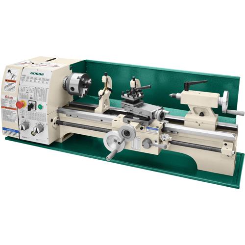

G0602 10" x 22" Benchtop Metal Lathe
An efficient benchtop machine with a powerful 1 HP motor, and all the features you need for accurate machining on every project!
The Grizzly G0602 Benchtop Metal Lathe is the perfect size for garage or workshop at 10" x 22". It features a 25mm spindle bore, 1-3/4"- 8 TPI MT#4 headstock and an 1-1/4" MT#3 tailstock.
It is a robust, no-nonsense lathe built for versatility–ideal for turning, facing, and threading projects in garages or small shops with limited space.
The 1 HP motor powers the spindle through six speeds from 150-2400 RPM.
This lathe comes equipped with a full featured carriage and apron assemblies that provide super accurate cuts and finishes. This Benchtop Metal Lathe will cut only right-hand threads.
The G0602 includes other exceptional equipment you’ll need to get up and running including: the hardened and precision-ground V-ways, 5" 3-Jaw chuck with two sets of jaws, 6-1/2" 4-jaw chuck with reversible jaws, 8" faceplate and 4-way tool post.
The G0602 manual was written by our U.S.-based Documentation Department is packed with useful information. The complete and easy-to-read manual makes it easier to assemble and maintain your lathe.
