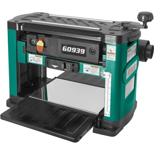

G0939 13" 2 HP Benchtop Planer
A benchtop planer to make easy work of those tough surfacing projects.
This G0939 13" 2 HP Benchtop Planer is equipped with a stainless steel table that provides smooth planing, never rusts, and stays tarnish-free for the life of the planer.
The cutterhead raises and lowers in the fixed-height table design. This allows for permanent infeed and outfeed roller setups.
The 2" diameter 3-knife cutterhead provides a smoother first-pass finish compared to a 2-knife cutterhead. A blade-setting jig is included.
The HSS knives (high-speed steel) have been heat treated for hardness and wear resistance, which keeps a sharp edge longer than other carbon steels.
You just can’t beat the value and performance of this amazing portable planer.
The easy carry handles make this planer great for the job site and easy stow-away for any home shop.
The G0939 also features a depth-of-cut indicator that reads up to 1/8" and includes a convenient side mount 2" dust port with 4" adaptor.
Like all Grizzly benchtop thickness planers, the G0939 comes with a one-year warranty covering parts and assuring the unit is free from factory defects. (Consumables are not covered by the warranty.)
The G0939 manual was written by our U.S. based Documentation Department and is packed with useful information. The complete and easy-to-read manual makes it easier to assemble and maintain your planer.
The Grizzly Technical Support team is U.S. based. Parts for the planer may be available online and shipped from the Grizzly parts warehouse in Springfield, MO.
