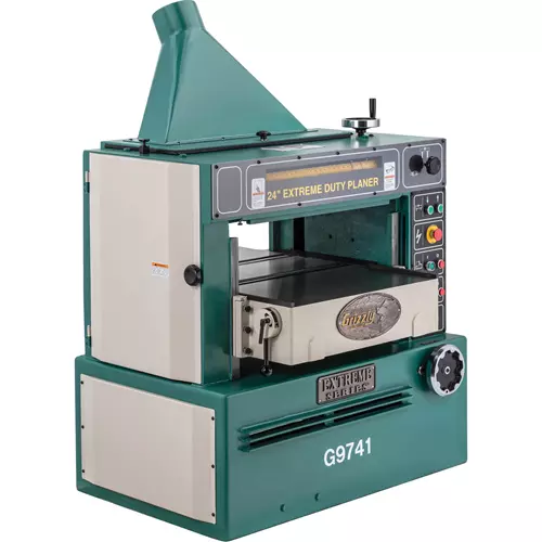

Grizzly G9741 - 24" 10 HP 3-Phase Extreme-Duty Planer
No Reviews
$12,975.00
  • Motor: 10 HP
  • Max cutting width: 24 in.
  • Max cutting height: 9 in.
  • Cutter Head Type: 4 Knife
  • Cutter Head Diameter: 4 in.
  • Min Stock Length: 10-1/2 in.
  • Feed Rate(s): 20–40 FPM
  • Table size: 24 in. x 35-1/2 in.
  • Shipping weight: 1935 lbs.
G9741 24" 10 HP 3-Phase Extreme-Duty Planer
The 10 HP "big daddy" in our line of extreme-duty planers!
The G9741 24" 10 HP 3-Phase Extreme-Duty Planer has all the features one would expect of an industrial machine this big. It has segmented chip breakers to improve chip control and to reduce cutting resistance, variable-speed feed and motorized table elevation. The bed rollers on this machine are also power driven and adjustable for height when milling rough-cut lumber.
The G9741 features a 4-knife cutterhead, an inch and metric measuring scale and variable-speed feed rate of 20–40 feet per minute, so you can dial in for the best possible finish.
The HSS knives (high-speed steel) have been heat treated for hardness and wear resistance, which keeps a sharp edge longer than other carbon steels.
The weight of the massive 6" thick, precision-ground cast-iron table will minimize vibration and ensure straight cuts.
Better believe this machine can hold up to the most strenuous production runs.
The G9741 manual was written by our U.S.-based Documentation Department is packed with useful information. The complete and easy-to-read manual makes it easier to assemble and maintain your planer.
*This machine is prewired for 220V. We can rewire to 440V in a few days’ time for a fee. Please contact Grizzly Technical Support at (570) 546-9663 before placing your order.
  • Motor: 10 HP, 220V/440V* (prewired 220V), 3-phase, 30A/15A
  • Table elevation motor: 1/2 HP, 2A
  • Feed motor: 1 HP, 4A
  • Minimum circuit size: 40A @ 220V, 20A @ 440V
  • Maximum stock width: 24"
  • Maximum cut height: 9"
  • Minimum stock length: 10-1/2"
  • Minimum stock thickness: 1/4"
  • Maximum stock thickness: 9"
  • Maximum cutting depth: 1/8"
  • Cutterhead speed: 5000 RPM
  • Feed rate: Variable, 20–40 FPM
  • Cutterhead type: 4-knife
  • Cutterhead diameter: 4-5/8"
  • Knife size and type: 24-1/8" x 1-3/16" x 1/8", HSS
  • Table size: 24" x 35-1/2"
  • Dust port size: 5"
  • Footprint: 30" x 40-1/2"
  • Overall dimensions: 42-3/8" W x 36" D x 58" H
  • Approximate shipping weight: 1935 lbs.
  • Twin V-belt drive (cutterhead), chain drive (feed and elevation)
  • Motorized table elevation with micro-adjust handwheel
  • Inch and metric measuring scale
  • Convenient control panel with magnetic switch protection
  • Massive 6" thick precision-ground cast-iron table with bed rollers
  • Segmented chip breaker and feed rollers
  • Variable-speed feed
  • Table height lock
  • 1-year limited warranty
