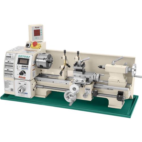

G0768Z 8" x 16" Variable-Speed Lathe with X/Z-Axis DRO
A versatile and precise lathe for making parts.
The Grizzly G0768Z features an electronic variable-speed spindle control that ensures cutting precision on every project.
Take advantage of the high/low speed ranges and digital RPM readout to increase your efficiency.
And, with a X/Z-Axis DRO, you can closely monitor cross slide and carriage travel for the accuracy needed for each step.
This specialized lathe is also equipped with a quick-lock tailstock for smooth and easy adjustments; keep your productivity up while on the job site or in your home workshop!
The G0768Z works perfectly on sturdy workbench or as a stand-alone unit when mounted on the T26599 Optional Stand.
Additionally this lathe has a convenient quick-lock tailstock, reverse feed for cutting left-hand threads, and a great selection of included standard equipment.
The G0768Z manual was written by our U.S.-based Documentation Department is packed with useful information.
Parts for the lathe may be available online and shipped from the Grizzly parts warehouse in Springfield, MO.
