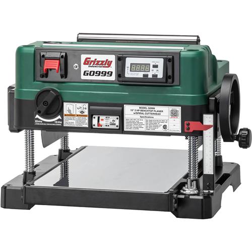

G0999 15" 2 HP Benchtop Planer with Spiral Cutterhead
Wide planing capacity with the convenience of benchtop operation.
Expand your planing capabilities with this powerful, sturdy planer that will immediately boost production, whether you have a professional woodworking shop or are a DIYer kicking out home projects.
With a generous 15" cutting width, this benchtop planer is ready for production-level processing. The 2 HP motor lets you power through all types of wood with ease and efficiency, even with heavy use.
Two feed rates give you precise control over the planing process for consistently smooth workpieces. And with the built-in DRO, you won't need to make multiple passes to get uniform board thicknesses.
This large-capacity planer is also equipped with a depth stop as well as an efficient spiral cutterhead that provides tear-out free finishes for tabletops, door frames, and even wooden decking.
FEATURES AND BENEFITS:
  • Wide Capacity: Boost production by planing boards up to 15" wide for large-scale projects.
  • Two Feed Rates: Switch between 12 and 22 FPM depending on the wood variety and desired speed of material removal.
  • Built-in DRO: Easily monitor and change planing thickness – no more guesswork required!
  • Depth Stop: Set up to five pre-set planing thicknesses so switching between projects is quick and easy.
  • Spiral Cutterhead: Get a smooth finish on every workpiece with 32 indexable carbide inserts that you can rotate as needed for a fresh, sharp edge.
To use, simply plug the planer into a grounded 120V 5-20 receptacle. It is that easy!
  • Required power source: 120V, single-phase, min. 20A circuit
  • Motor: 2 HP, 120V, single-phase, 16.5A
  • Maximum stock width: 15"
  • Maximum stock thickness: 6"
  • Minimum stock thickness: 3/16"
  • Minimum stock length: 8"
  • Maximum cut depth full width: 1/16"
  • Maximum cut depth 6" wide: 1/8"
  • Cutterhead diameter: 2-3/8"
  • Cutterhead type: Spiral
  • Insert size: 15mm x 15mm x 2.5mm
  • Cutterhead speed: 5600 RPM
  • Feed rate: 12, 22 FPM
  • Table size: 23" L x 15" W x 2" Th.
  • Dust port size: 4"
  • Footprint: 23-1/2" x 19"
  • Overall dimensions: 28-1/2" W x 29-1/2" D x 18-1/2" H
  • Approximate shipping weight: 157 lbs.
Take on projects beyond the capabilities of other benchtop planers with the Grizzly G0999 15" 2 HP Benchtop Planer. Get one today!
