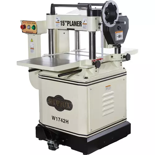

Shop Fox W1742H 15" Helical Cutterhead Planer
Create uniform thickness and flatness to improve your lumber.
The Shop Fox W1742H Planer features everything you ever wanted in a 15" planer, including an affordable price.
The 15", 5-row helical cutterhead comes complete with 75 indexable carbide inserts that can each be rotated three times to expose new, sharp cutting edges.
The inserts sit at a slight angle to the for smooth shearing cuts, minimized tearout, a smoother finish, and operating at lower noise levels.
A 240-volt, 3 horsepower motor powers through cuts up to 3/32" deep at full width or 1/8" deep on material up to 6" wide.
The 2-speed gearbox allows you to choose between 16 and 30 FPM for a smooth finish or high-production feed rate.
The W1742H 15" Planers are equipped with a pedestal-mounted thermal-overload safety switch, cast-iron extension wings, and a built-in mobile base.

  • Motor: 3 HP, 240V, single-phase, 15A
  • Maximum cutting width: 15"
  • Maximum cutting height: 8"
  • Minimum stock width: 3/16"
  • Minimum stock length: 8"
  • Maximum cut depth full width: 3/32"
  • Maximum cut depth 6" wide: 1/8"
  • Cutterhead diameter: 3"
  • Cutterhead type: 5-row helical, 75 inserts
  • Feed Rate: 16 FPM, 30 FPM
  • Table size including wings: 15" W x 42" L x 1-3/4" T
  • Dust port size: 4"
  • Overall dimensions: 42" W x 32-1/2" D x 46" H
  • Approximate shipping weight: 667 lbs.
  • Two-year warranty!!
  • Helical cutterhead with 75 indexable carbide inserts
  • Built-in, easy-to-use mobile base
  • Chip breaker and pressure bar
  • Precision-ground cast-iron extension wings
  • Pedestal-mounted control switch
  • Inch and metric measurement table elevation scale
  • Two adjustable bed rollers
  • Top-mounted board return rollers
  • Four-column support with positive table locks
  • Two-speed automatic board feed
