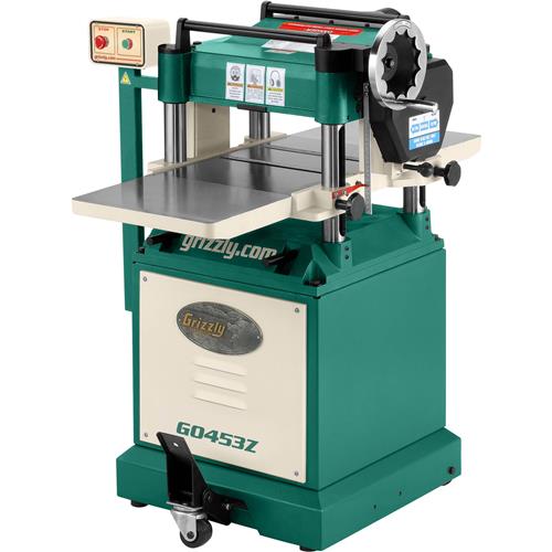

G0453Z 15" 3 HP Planer w/ Spiral Cutterhead
Upgrade to a spiral cutterhead with power to spare.
The G0453Z 15" 3 HP Planer w/ Spiral Cutterhead recognized ahead of the rest of the 15" planers tested by WOOD Magazine for its combination of clean cuts and the ability to control snipe.
The 4-row spiral cutterhead with 74 German-made indexable carbide inserts cut some of the finest surface finishes money can buy.
Each insert can be rotated up to three times to expose a new sharp edge for superior finish.
Reducing the cut to the size of a single insert makes for a cleaner cut and reduces noise compared to the traditional straight knife cut.
The 3 HP motor spins the cutterhead at 4800 RPM to plane your stock up to 15" wide by 8" thick, cutting as deep as 1/8" per pass.
Additionally, the G0453Z features a built-in mobile base, adjustable bed rollers, two-speed automatic board feed, and solid cast-iron extension wings.
Like all Grizzly planers, the G0453Z comes with a 1-year warranty which covers parts and assures the unit is free from factory defects. (Consumables are not covered by the warranty.)
The G0453Z manual was written by our U.S.-based Technical Documentation Department and is packed with useful information. The complete and easy-to-read manual makes it easier to assemble and maintain your planer.
The Grizzly Customer Service and Technical Support Teams are also U.S.-based. Parts for the planer may be available online and shipped from the Grizzly parts warehouse in Springfield, MO.
