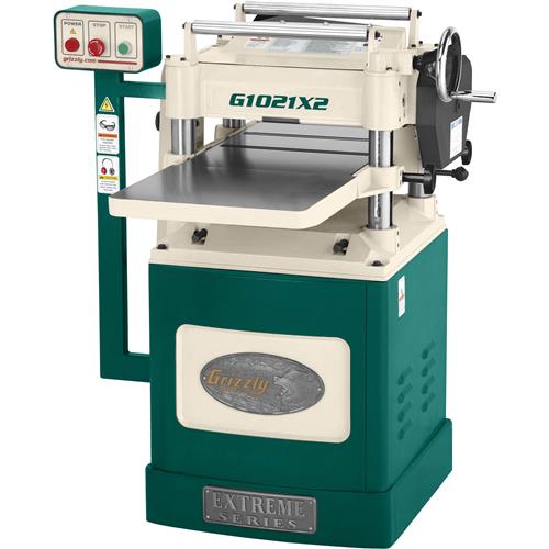

Grizzly G1021X2 - 15" 3 HP Extreme Series Planer w/ Helical Cutterhead
4.8 (122)
108
$3,150.00
  • Motor: 3 HP
  • Max cutting width: 15 in.
  • Max cutting height: 6 in.
  • Cutter Head Type: Helical
  • Cutter Head Diameter: 3 in.
  • Min Stock Length: 6 in.
  • Feed Rate(s): 16, 28 FPM
  • Table size: 48 in. x 15 in.
  • Shipping weight: 553 lbs.
G1021X2 15" 3 HP Extreme Series Planer with Helical Cutterhead
Maximize the quality of finish straight from the planer.
Using the G1021X2 3 HP Planer will save time and effort by quickly flattening and smoothing rough lumber.
The G1021X2 features a 15", 4-row helical cutterhead complete with 52 indexable inserts that can each be rotated three times to expose new, sharp cutting edges.
The indexable carbide inserts are positioned along a helical pattern with the cutting edges at a slight angle to the workpiece. This angle allows for smooth shearing cuts, minimized tearout, a smoother finish, and operating at lower noise levels.
The G1021X2 features a powerful 230-volt, 3 horsepower motor to power through cuts up to 3/32" deep at full width or 1/8" deep on material up to 6” wide.
Plane material from 3/16" to 6" thick with ease and choose between either 16 or 28 feet per minute feed rates for the perfect finish.
The precision-ground cast-iron table travels smoothly up and down on the heavy-duty 4-column supports and can be firmly locked in place for operation.
The G1021X2 offers additional features such as extra-large ball bearing return rollers, a large side-mounted handwheel, cabinet-style stand, pedestal-mounted control panel, magnetic switch with thermal overload protection and powder coated paint for years of protection.
Like all Grizzly planers, the G1021X2 comes with a 1-year warranty which covers parts and assures the unit is free from factory defects.
The G1021X2 manual was written by our U.S.-based Technical Documentation Department and is packed with useful information. The complete and easy-to-read manual makes it easier to assemble and maintain your planer.
The Grizzly Customer Service and Technical Support Teams are U.S.-based. Parts for the planer are available online and shipped from the Grizzly parts warehouse in Springfield, MO.
CSA certified
